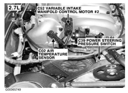

WHAT IS THIS CODE AND WHERE IS THE PART LOCADED

Hi there, This is an air temp sensor or circuit fault, you will have to check the sensor and the circuit.
https://images.2carpros.com/forum/automotive_pictures/61395_text_1.png
https://images.2carpros.com/forum/automotive_pictures/61395_Capture_1.jpg
