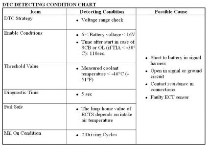

Yes one trouble code p0118 and i actually have been monitoring my coolant and after filling it up noticed that it was down below the low line in just a week, does this have any affect on the rpm's rising when im in park or nuetral, or the bucking of the vehicle when im driving?
Nov 4, 2010 at 3:05 PM
KHLOW2008
  • 41,814 POSTS
P0118 is a fault with the Engine Coolant Temperature sensor and it can cause the the symptoms. There is coolant leakages in the system and you need to locate and rectify the problem. If visual inspection does not reveal anything, a leak down/pressure test would be required to locate the source of the leak. When coolant level is correct, and problem does not occur, then rectifying the leak should solve the problem. If it occurs most of the time, even after topping up the coolant, then you would have to diagnose and tectify the code.
https://images.2carpros.com/forum/automotive_pictures/192750_P0118Condition06Tiburon_1.jpg
