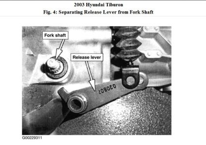

I'm replacing my clutch on my tiburon; I got all bolts out of bell housing, disconected axles and all accesories around tranny, noticed that tranny is stuck , seems like special way to disengage trow out bearing, because I can see thru a and acces holethat release bearing works opposite than traditinal clutch systems instead of pushing on plate is pulling. I hope you can answer my question as soon as possile because I need my wheels on the road again. THANKS SO MUCH FOR YOUR TIME

Hi there, Thank you for the donation, I have not done this before but reading the relevant section on Mitchell 1 remove slave cylinder retaining bolts, take off release lever to slave clevis pin and take the lever of the arm, see pic and the transmission should come away, see how you get on, let me know if you still have trouble.
https://images.2carpros.com/forum/automotive_pictures/61395_Capture_86.jpg
