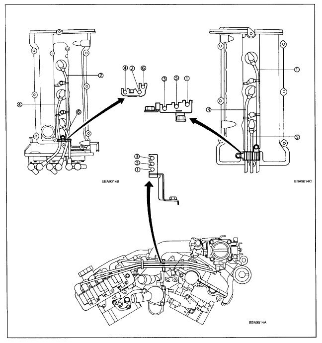

firing order?
2003 HYUNDAI TIBURON
MARINE01
where is the #1 cylinder on this vehicle 2.7L 6cyl?
Feb 22, 2010 at 10:50 AM
  • 55,433 POSTS
Hey MARINE01,
Here is the firing order for your engine
Firing Order .................... 1-2-3-4-5-6

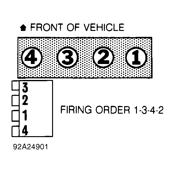

MICHAELSMITHEY
  • 41 POSTS
can you show me a diagram of where each spark plug wire is supposed to go,think one may be crossed up,97 hyundai tiburon 2.0
Dec 3, 2020 at 12:47 AM (Merged)
  • 75,992 POSTS
Here is the engine spark plug firing order. Check out the diagrams (Below). Please let us know if you need anything else to get the problem fixed. Cheers
