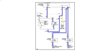

Back up lights do not work.
No poer to light sockets.
Where is the switch for the back up lights?

Welcome to 2carpros and TY for the donation Check and test fuse no.3 10amp if okay find the back-up lamp switch on the transaxle disconnect the wiring connector check for power at the red wire if power is present jumper the wiring connector -if the light works-replace the back up switch
