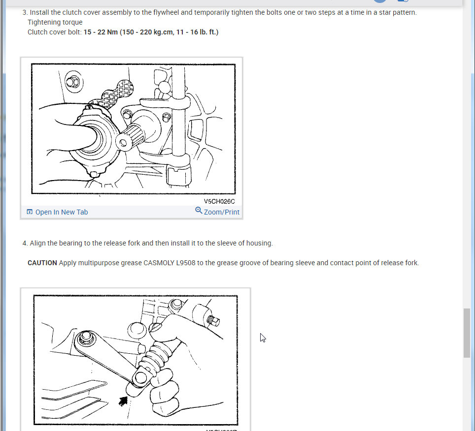

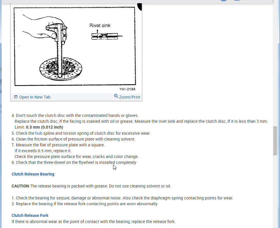

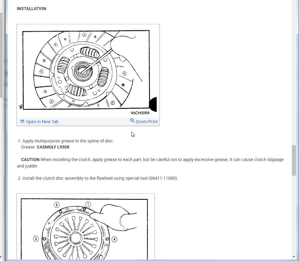

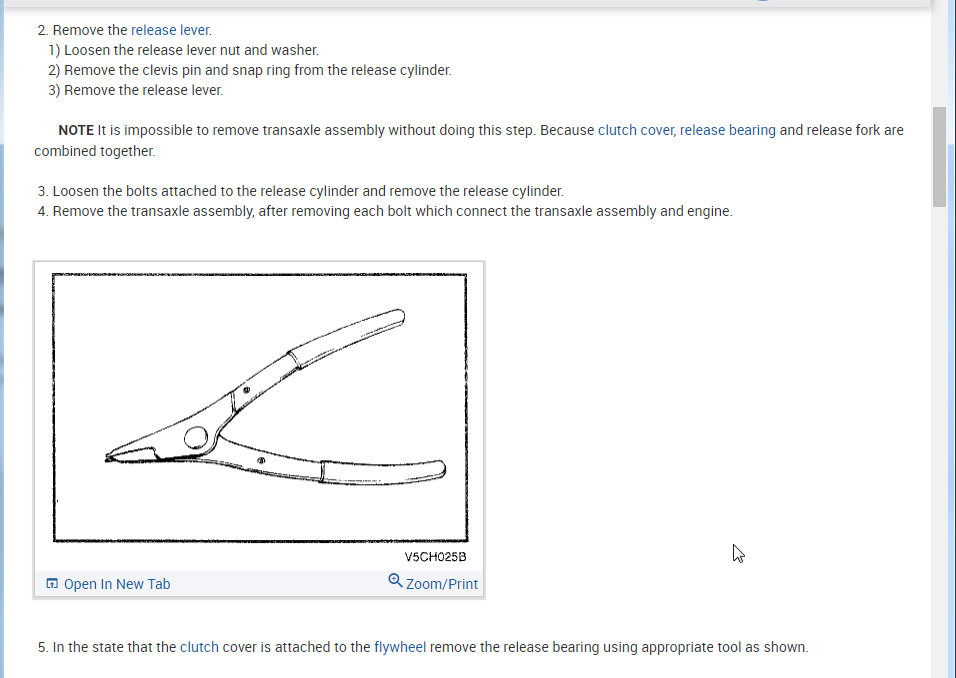

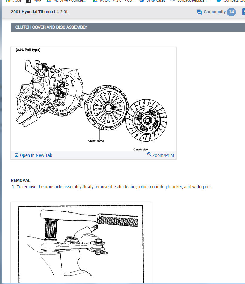

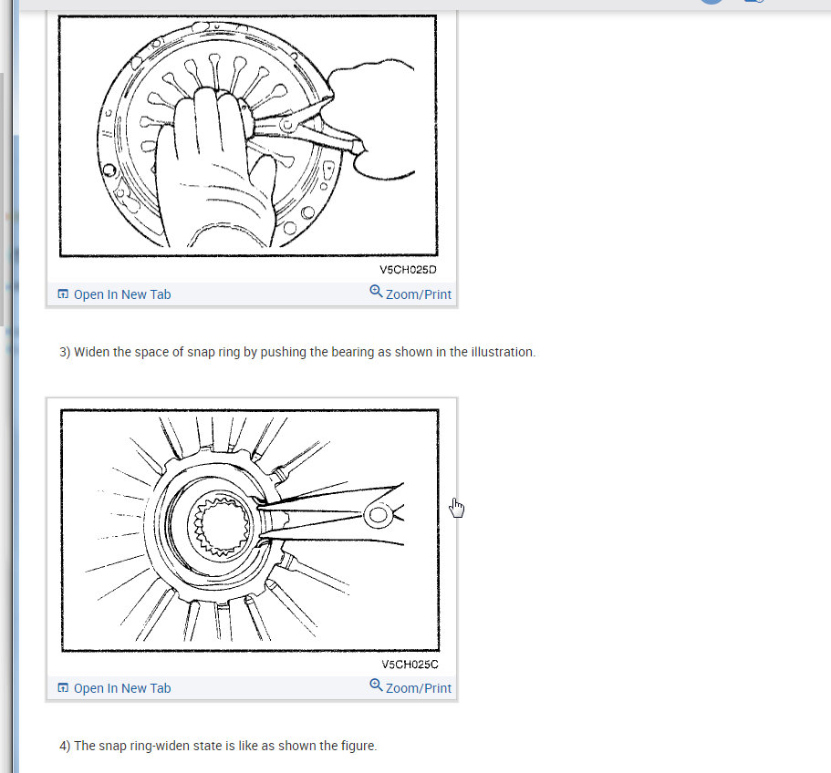

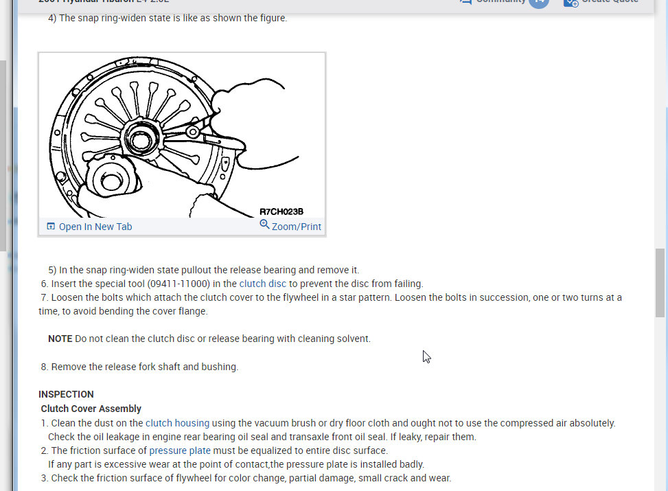

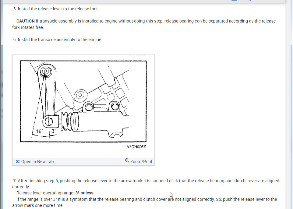

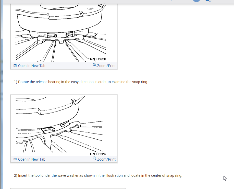

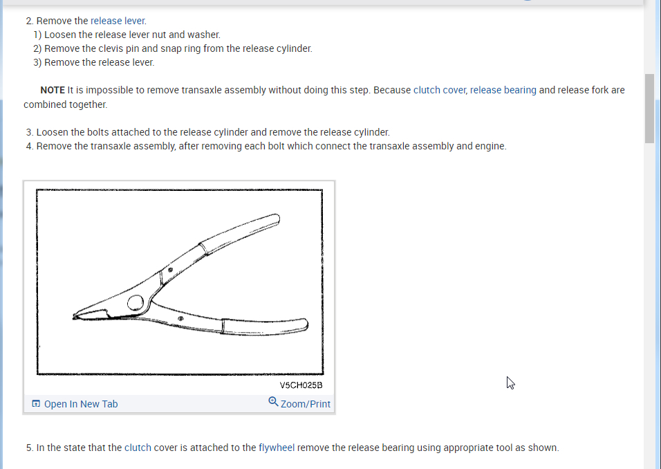

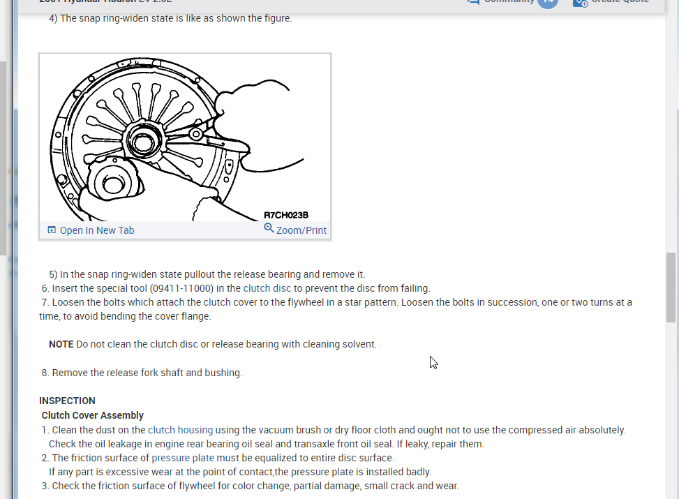

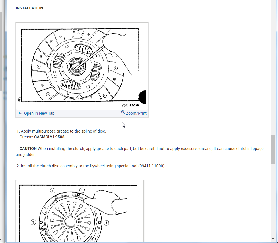

Lastly here is the process from the manual that will show you what you need to do to replace it. Let us know what questions you have.
Thanks.
