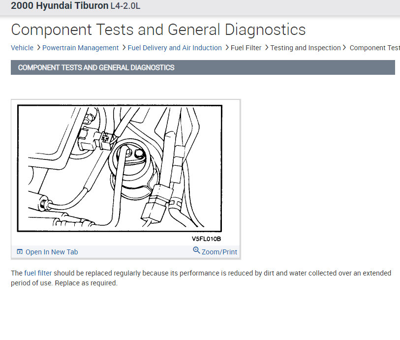

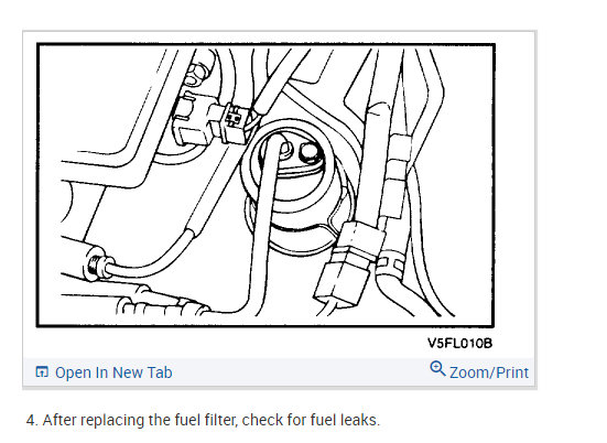

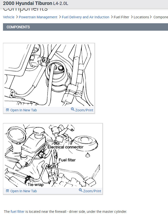

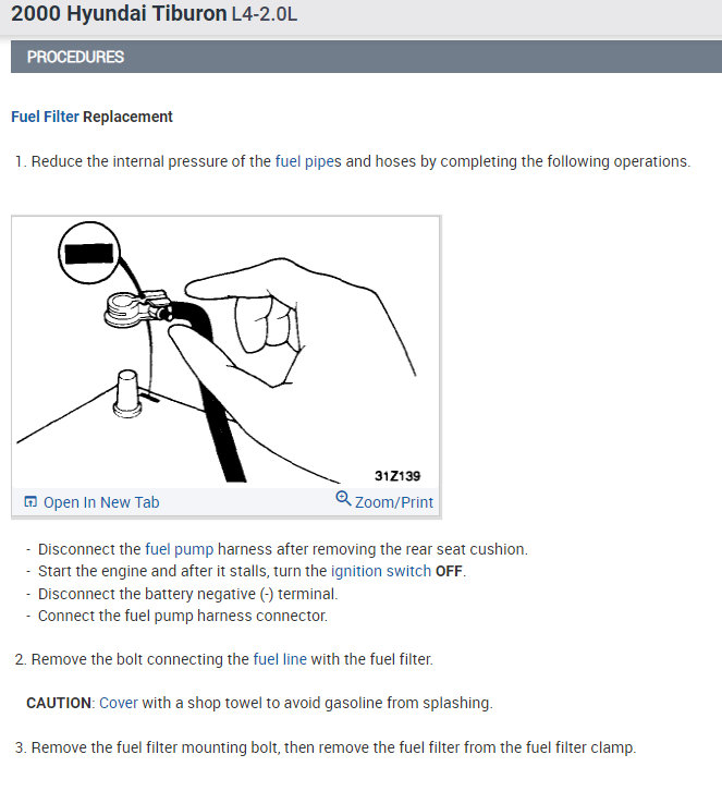

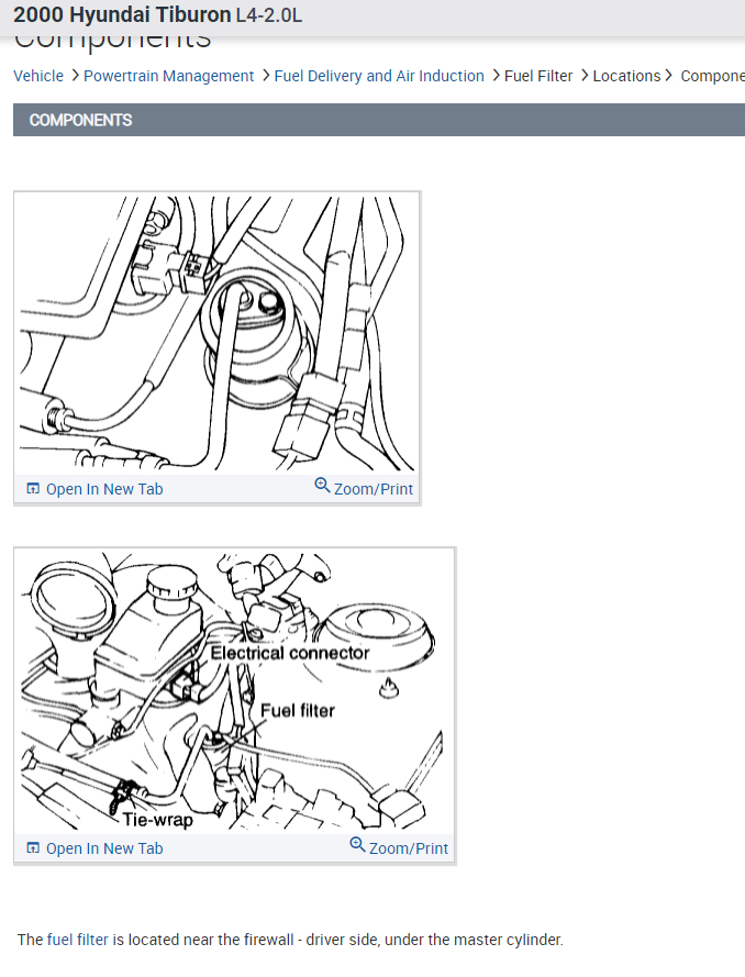

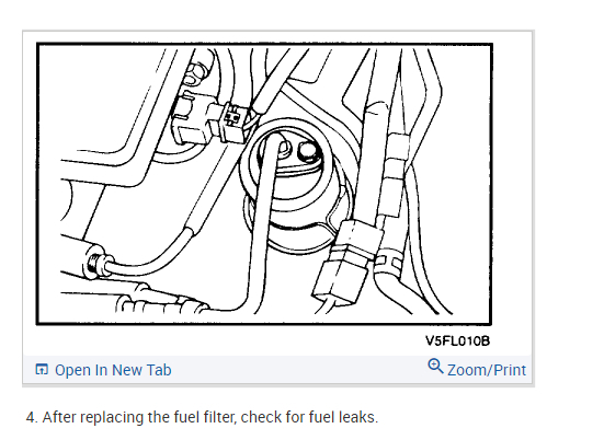

Also the fuel filter needs to be checked. If there is a clog in the fuel filter you can experience this type of issues.
The fuel filter is located near the firewall - driver side, under the master cylinder.
