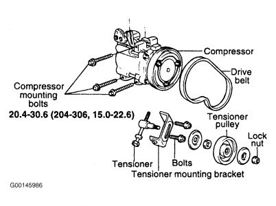

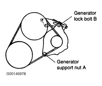

How do I install a new AC belt. the alternator belt is in the way and I can't seem to budge the the thing even after loosening the bolts. What am I missing?

See diagram
https://images.2carpros.com/forum/automotive_pictures/198357_Graphic_465.jpg
Loosen bolt A then B then screw adjustment bolt to loosen. See A/C diagram
