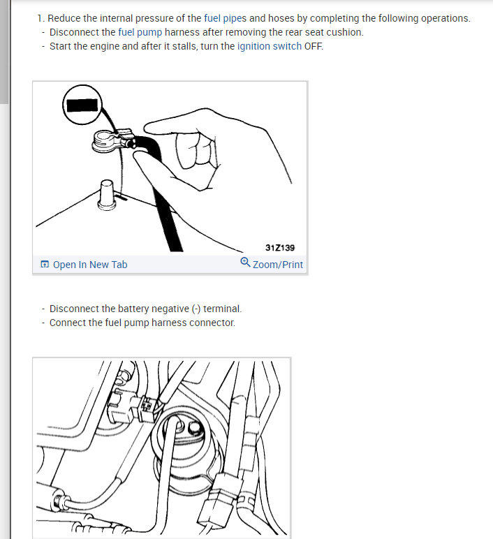

im trying to replace a fuel filter on my 1997 hyundai tiburon fx coupe 2.0L 4Cyl, the fuel line that runs into the top of it uses a 10MM bolt, and the housing that it clamps into uses a 10MM bolt, however the fuel line that bolts into the bottom uses a different size bolt, and for the life of me i cant figure out what size it is. Help please?

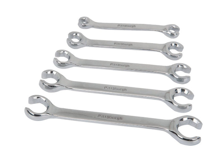

The bottom hex is a 14mm, but I would not use a box wrench. I would suggest using a wrench called a flared end wrench. Basically, this is what these wrenches are for so that you don't roll the edges.
If you can't get it off, I would suggest just cutting the line a little further back and then put a new flare line on it and connect it with a repair kit.

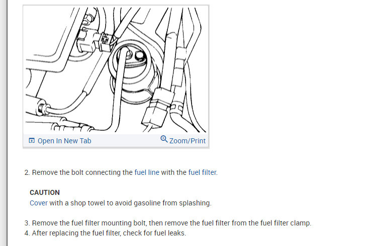

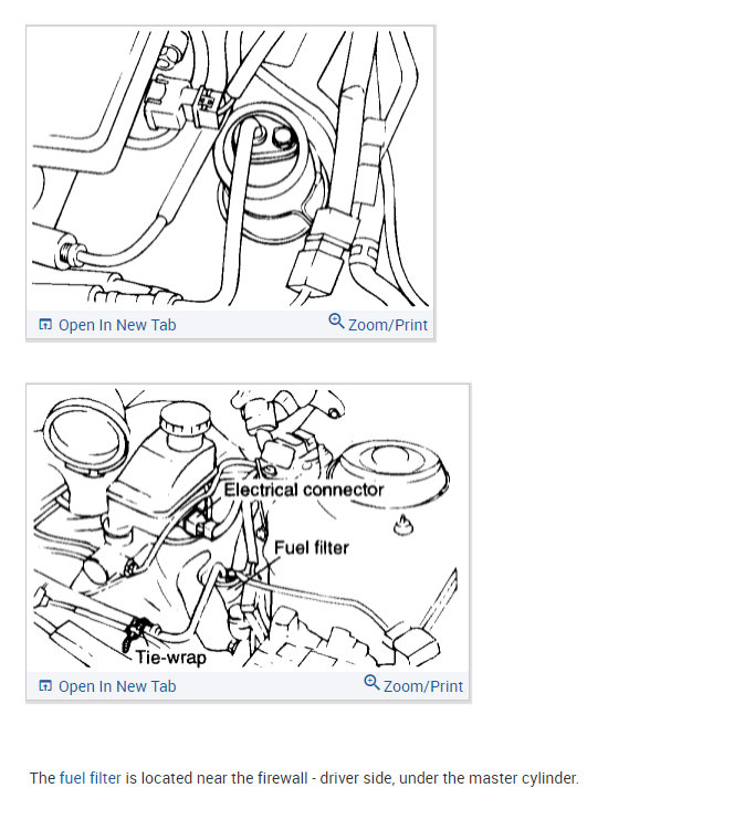

I attached the fuel filter info below. Please run through this and let us know what questions you have. Thanks

I tried 14MM, and all it did was round over the edges, was too big, also, it's impossible to fit a pipe wrench in there. I ended up eventually getting it with a crescent wrench, and the clamp that the filter was in holds it fine for loosening
