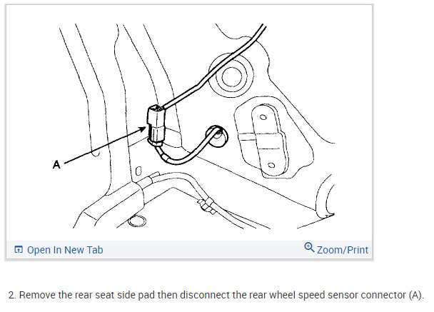

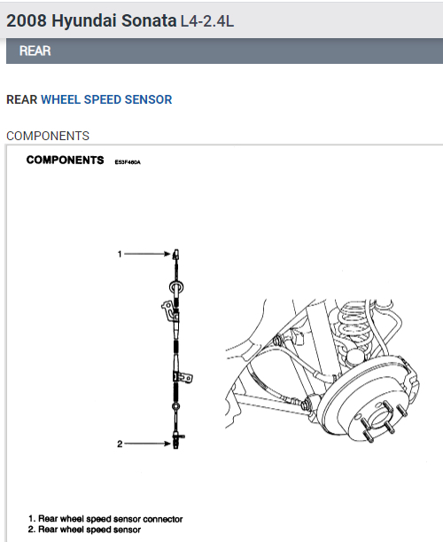

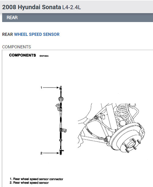

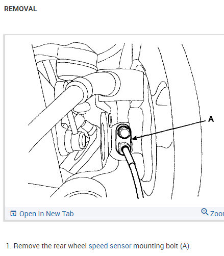

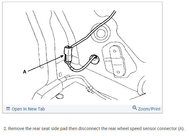

I was installing new rear rotors and I can't get the old ones off. I removed the mounting screw and all of the associated hardware, but the rotor will not budge. I released the emergency brake also. They seem to be stuck on due to heat or corrosion I would imagine. I finally got the rotor off but I wrecked the wheel speed sensor.

Here is the information you requested. This is a tutorial for you to view on how to replace a wheel speed sensor:
https://www.2carpros.com/articles/how-to-replace-an-abs-wheel-speed-sensor
I've attached picture steps below on how to replace the wheel speed sensor on your vehicle. Hope this helps and thanks for using 2CarPros.
