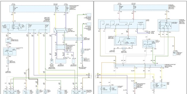

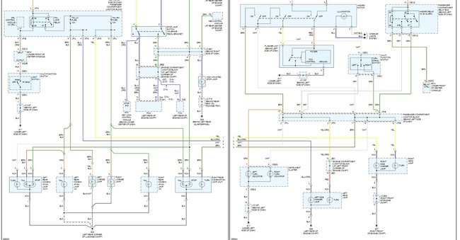

The third brake light works but the other two do not. fuses look ok. I'm looking for a wiring schematic so that I may pinpoint some common areas . Any help on where to find the info? or where to start looking?
Mar 18, 2008 at 8:55 AM
  • 75,988 POSTS
Could be something as simple as the brake light switch, but test the fuses with a test light, don't just look at them
Read the guides below on testing wiring and using a test light, they will help
The wiring diagrams for all of the exterior lights in your car area attached below
