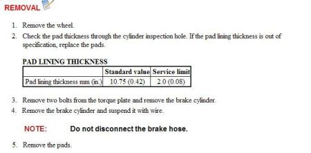

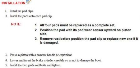

Can you tell me how to replace the rear rotors. The front cost me $400 and I think that may have been a bit high. Is there anyway that I can do it myself or do I need some special wheel puller?
Feb 23, 2010 at 1:55 PM
BLUELIGHTNIN6
  • 16,542 POSTS
https://images.2carpros.com/forum/automotive_pictures/261618_Noname_1741.jpg
https://images.2carpros.com/forum/automotive_pictures/261618_Noname2_547.jpg
https://images.2carpros.com/forum/automotive_pictures/261618_Noname3_210.jpg

bluelightnin6 - thanks for the info - BUT - what I asked was how to replace the rear ROTORS not the pads.
Feb 24, 2010 at 6:42 PM
BLUELIGHTNIN6
  • 16,542 POSTS
yes once the rear brake caliper has been removed the rotor will slide off. be certain the parking brake is not engaged though .
