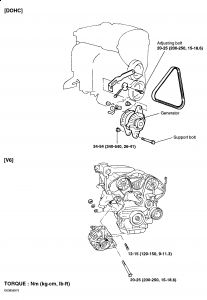

what tool is needed to get to the alternator in our 2005 Sonata GL? Do you have any special instructions for changing the alternator?

No special tools needed. Loosen belt adjuster remove belt. unbolt alt from block.
