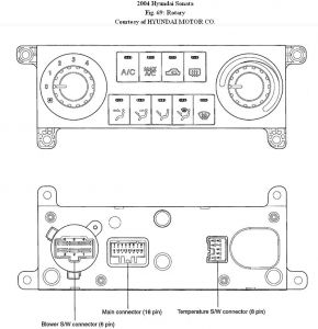

I have a 2004 Hyundai , when I try to change the air circulation by pressing the button for face , or leg or
front or windshield , it seems to stay on windshield and and legs no matter what button I press it will not change .
yesterday I tried and it start working again then it got stuck on only legs and front for vent . Is that a fuse or the whole unit ? no clue why ? maybe minor fuse ?
or the interchange ?
Aug 23, 2010 at 3:31 AM
KHLOW2008
  • 41,814 POSTS
Hi josephr, Thank you for the donation. Symptoms indicates a possible fault with the control panel.
https://images.2carpros.com/forum/automotive_pictures/192750_HVACControlPanel04SonataFig69_1.jpg

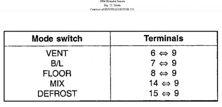

Chck for continuity between terminals with the button depressed according to the modes specified.
https://images.2carpros.com/forum/automotive_pictures/192750_HVACControlPanel04SonataFig72_1.jpg
If continuity is not as specified, the control panel is bad.
