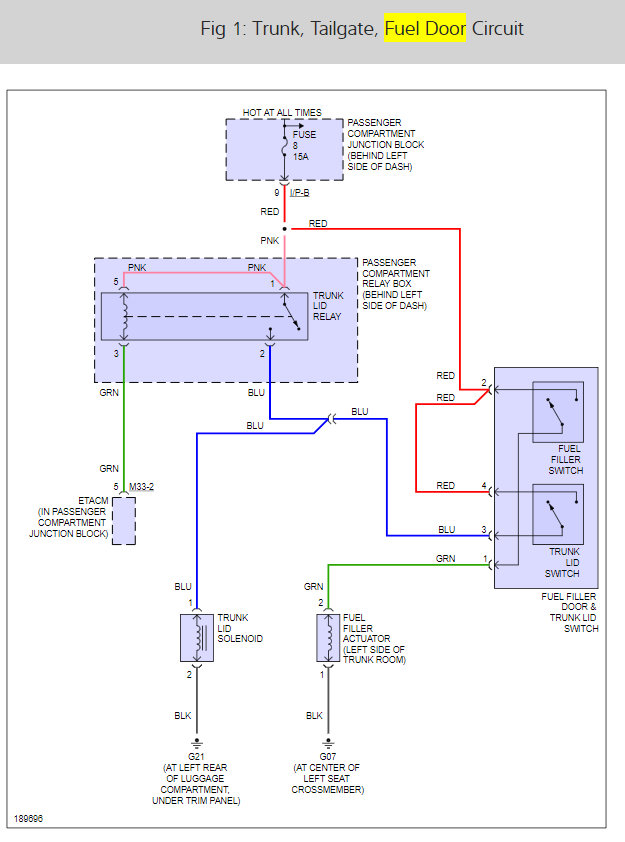

It quit opening and the manual was not helpful. The wife has to open the trunk when she gets fuel.

Check fuse # 8 (15 amp) in the passenger compartment junction block. This fuse protects the fuel filler door and the trunk lid switch circuits.
If the fuse is okay check for power through the switch. Here is a guide and the fuel door wiring diagram to show you how.
Cheers

I had this problem with my car. It was the switch that was bad.

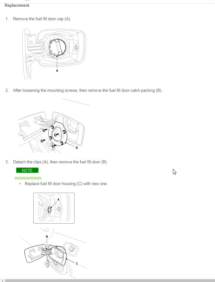

how do i replace the fuel filler door?

I attached the process on how to replace the actual door. You actually remove the insert and the door and hinge comes with it.
Let us know if you have more questions. Thanks

I am talking about the door you open to get to the fuel cap?
