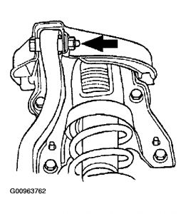

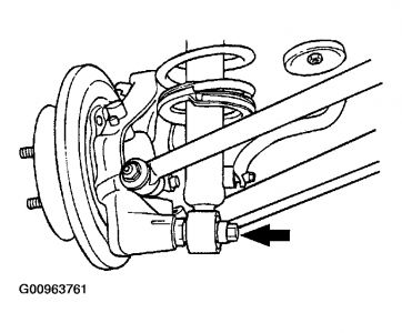

Need Instructions on how to remove the struts on this particular model. Unit is not attached at the top as it is normally designed on most vehicles. Can someone provide me the answer?

Remove bolts pictured below and strut should come loose.
