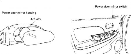

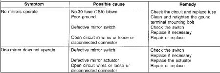

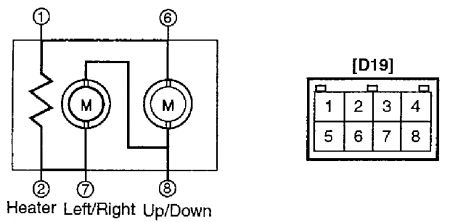

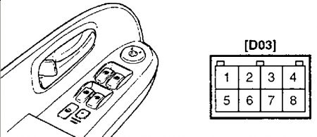

Outside rearview do not respond to electric control in
side car due to never being lubricated. Please describe process to lube both right and left mirrors. Thanks. Mike
Jul 12, 2009 at 5:34 AM
MERLIN2021
  • 17,250 POSTS
It's a sealed actuator, so it's not for lack of grease! It's either a bolwn fuse, or switch if both dont work! POWER DOOR MIRROR SWITCH INSPECTION 1. Remove the power door mirror switch from the door trim panel. 2. Check for continuity between the terminals in each switch position according to the table. If continuity is not as specified, replace the power door mirror switch. Fig. 3: Identifying Power Mirror Switch Connector & Terminals Courtesy of HYUNDAI MOTOR CO. Fig. 4: Power Mirror Switch Continuity Table Courtesy of HYUNDAI MOTOR CO. POWER DOOR MIRROR ACTUATOR INSPECTION 1. Disconnect the power door mirror connector from the harness. 2. Apply battery voltage to each terminal as shown in the table and verify that the mirror operates properly. Fig. 5: Identifying Power Door Mirror Connector Terminals Courtesy of HYUNDAI MOTOR CO. Fig. 6: Power Door Mirror Actuator Operational Check Table Courtesy of HYUNDAI MOTOR CO. MIRROR HEATER INSPECTION Fig. 7: Heated Mirror Inspection Table Courtesy of HYUNDAI MOTOR CO. REMOVAL & INSTALLATION 1. Remove the quadrant inner cover and the rear view mirror. Fig. 8: Identifying Rear View Mirror Bolts Courtesy of HYUNDAI MOTOR CO. DISASSEMBLY CAUTION: Wear gloves to remove and install the mirror holder. 1. Insert flat bladed screwdriver between the outside rear view mirror holder and the mirror assembly. Fig. 9: Inserting A Flat Bladed Screwdriver Between Outside Rear View Mirror Holder & Mirror Assembly Courtesy of HYUNDAI MOTOR CO. 2. Remove the outside rear view mirror actuator from the outside rear view mirror housing. Fig. 10: Identifying Outside Rear View Mirror Actuator Courtesy of HYUNDAI MOTOR CO. 3. Installation is the reverse of removal. CAUTION: When prying with a flat bladed screwdriver, wrap it with a shop towel to prevent damage.
