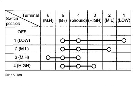

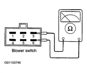

The fan/blower does come on. When you turn the knob it turns from 1 to 4 without any resistance at the no. intervals. The AC light doesn't come on but all the others do. I couldn't find a fuse for the blower. I found one for the air conditioning system but it was not blown.
Mar 21, 2009 at 4:54 PM
DAVE H
  • 13,384 POSTS
Hello .. thanks for the donation... much appreciated You will need to check or replace the switch first .. it sounds like the switch may be bad !! BLOWER SWITCH Check for continuity between terminals as shown below. Fig. 67: Blower Switch Continuity Table Courtesy of HYUNDAI MOTOR CO.
https://images.2carpros.com/forum/automotive_pictures/266999_hy_1.jpg
If continuity is not as specified, replace the control panel. Fig. 68: Checking Blower Switch Continuity Courtesy of HYUNDAI MOTOR CO.
https://images.2carpros.com/forum/automotive_pictures/266999_hy2_1.jpg
Hope this helps .. let me know
