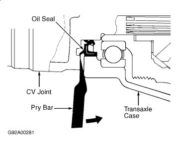

2002 Hyundai Sonata 4 cyl Front Wheel Drive Automatic
how does it come out of transmission side

Insert a pry bar between the transaxle case and the axle shaft, and pry the axle shaft from the transaxle NOTE:Do not pull on the axle shaft, doing so will damage the double offset joint Be sure to use the pry bar. Do not insert the pry bar deeply enough to damage the oil seal.
