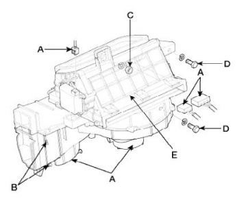

2002 Hyundai Sonata
how do i remove the heater blower motor
Mar 22, 2009 at 10:06 PM
BLUELIGHTNIN6
  • CAR REPAIR CONTRIBUTOR
  • 16,542 POSTS
REMOVAL: Disconnect the negative cable from the battery. Remove the dash pad. Disconnect the connectors from the blower relay the blower motor, the blower resistor (or power transistor) and the fresh and recirculation actuator. Remove the self-tapping screws (A), the mounting nut (B), the mounting bolt (C) and the blower unit (D).
https://images.2carpros.com/forum/automotive_pictures/261618_Noname_349.jpg
INSTALLATION: Installation is the reverse of removal. Thanks for using 2CarPros.com!
