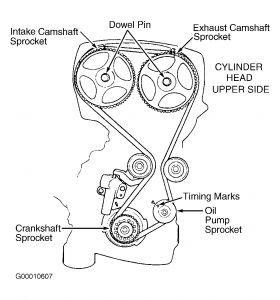

Ok I have a 2001 hyundai sonata 4 cyl and I replaced my crankshat position sensor an I moved the crankshaft pullie so it threw the timing offf were do the marks need to line up wit and isa there any way you can get me a diagrahm please and thank you....justin

Align crank shaft to No1 TDC and ensure cam and pump timing marks are as per pic. Mark (mhpautos)
