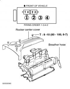

Just bought car, had to have emission test, failed with "#1 cylinder mis firing". In standing in front of the car, looking at engine, how do I identify which is the #1 cylinder.
Also, "check engine" light is on.
I plan to start by replacing plugs and plug wires. Any other suggestions?

have the vehicle plugged into a diagnostic scanner to locate the cause of the misfire !
https://images.2carpros.com/forum/automotive_pictures/266999_son_1.jpg
