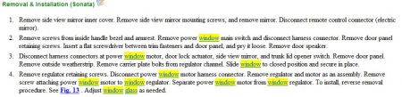

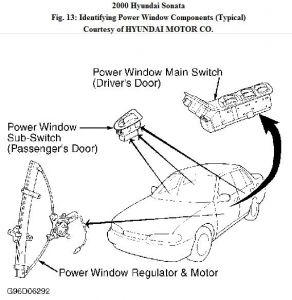

All of a sudden the passenger window stops short of going up into top window rubber groove and makes alot of wind noise going down road.
Any Ideas???

Hello !! Looks like the window motor assembly get out of alignment or the whole assembly got loose, here its the procedure to get in to the motor that way you can check the components and find what is wrong: BTW thanks a lot for your donation !! Good Luck!
