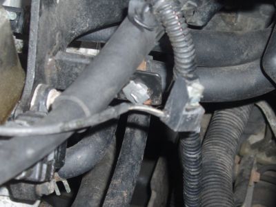

2000 Hyundai Sonata 4 cyl Two Wheel Drive Automatic 139k miles
my 2000 hyundi sonata, would not start today. On top of the engine under the spark plug cover coming out of the right side is a little wire that move from right to left and then attaches to a little bracket outside the engine on the right side.(Right side if your standing in front of the car). Any ideas or to vague?

Can you post a pic as this would be a big help.

Here is the picture.
https://www.2carpros.com/forum/automotive_pictures/532589_car_1.jpg

OK, still a bit of a challenge it does not look familiar at the moment, any chance of checking the wire codes, that is colour and trace, for both wires, that way I may be able to match it on a wiring schematic.

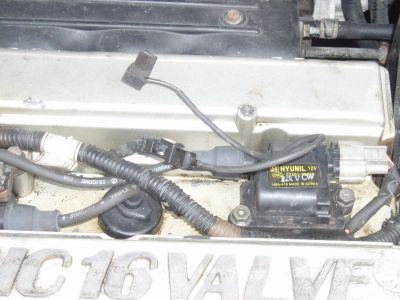

I'll pull the spark plug cover off and show you from that view

Maybe this view will help?
https://www.2carpros.com/forum/automotive_pictures/532589_car_002_1.jpg

Thats better, now I know what to look for, now its after midnight here any I can hear my bed calling my name, I will get onto this first thing in the morning.

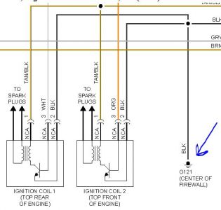

MHPAUTOS
  • 31,937 POSTS
Hi there,
OK, this is an Earth wire, it will join the other coil and hook up to a wire on the fire wall.
https://www.2carpros.com/forum/automotive_pictures/61395_Capture_7.jpg
martk (mhpautos)
