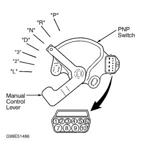

The 707 is PNP switch fault park neutral switch on top of trans axle that shift cable attaches. Need to remove cable so can shift with manual lever see diagram
https://images.2carpros.com/forum/automotive_pictures/198357_Graphic_547.jpg
With OHM meter check for continuity between following terminals If any fail replace switch. And Advance Auto has Cam sensor for $94 P 3&8 - 9&10 R 7&8 N 4&8 - 9&10 D 1&8 3 5&8 2 2&8 L 6&8

Where is the camshaft position sensor on 2000 Hyundai Sonata GLS located? and is it easy to replace?
Aug 3, 2010 at 5:47 AM
DOCFIXIT
  • 18,828 POSTS
Piece O cake located near thermostat right rear engine one bolt pull out . May have to wiggle a bit to free O ring
