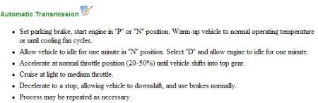

How do I reset the computer?

Hello Below is the info you requested.
https://images.2carpros.com/forum/automotive_pictures/261618_Noname_54.jpg
Hope this helps.. Thanks for using 2carpros.com!
