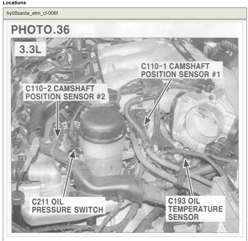

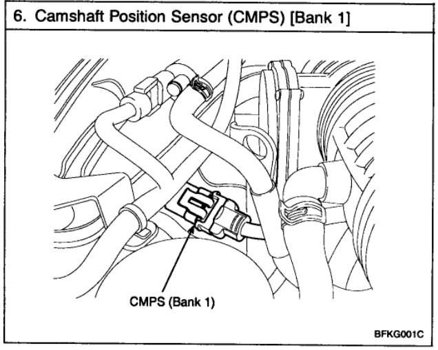

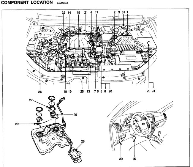

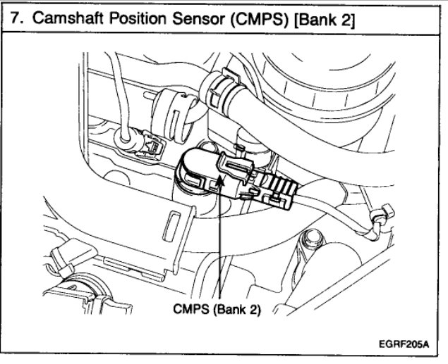

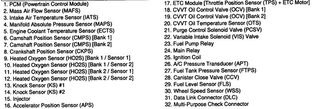

Hello All,
I have the vehicle listed above it is the Limited and I noticed the following problems:
1) Difficulty in starting.
2) Hard shifting between gears.
3) When the car is idle the sound goes high and low.
4) Sometimes while driving, the car goes off and I have to battle to start it again.
I did a scan and found out the following errors: camshaft position aensor "A" circuit, ignition coil "F" primary/secondary circuit and output speed sensor "A".
codes: P0356, P0722, P0356.
I need to know what to do next as I plan to buy replacements of these three parts, but I need advice.
Thanks
Jan 31, 2018 at 9:19 PM
  • 55,694 POSTS
It sounds like the problems will be fixed once you address each of the issues. Here are guides and diagrams (below) to help you get the job done:
https://www.2carpros.com/articles/engine-cranks-excessively-before-starting
and
https://www.2carpros.com/articles/camshaft-angle-sensor-replacement
