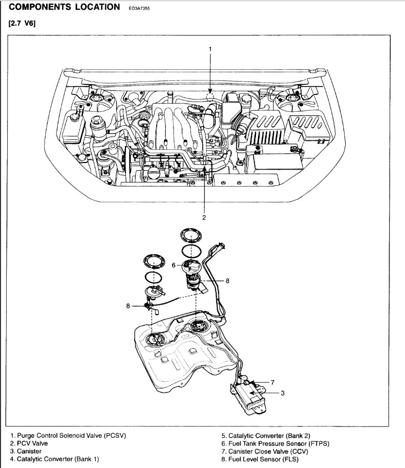

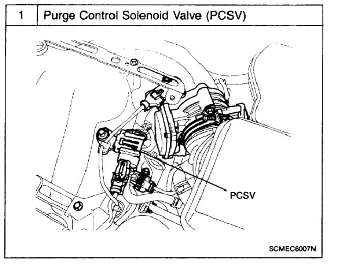

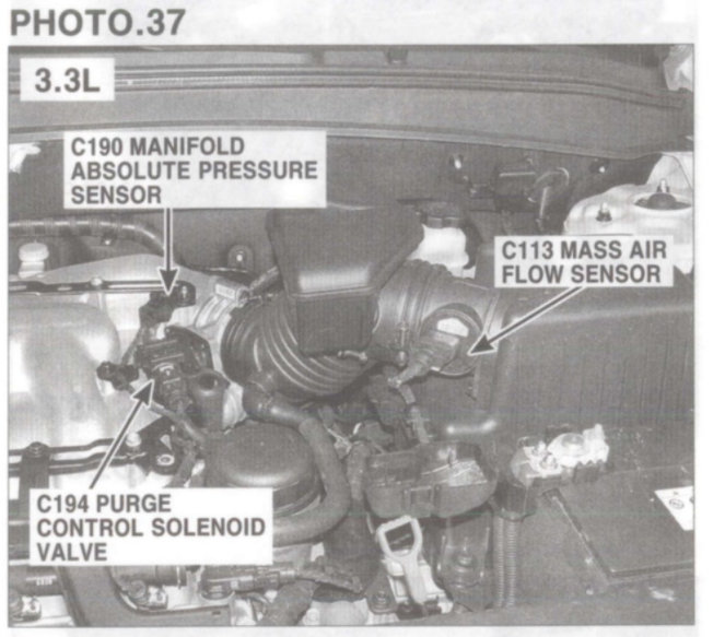

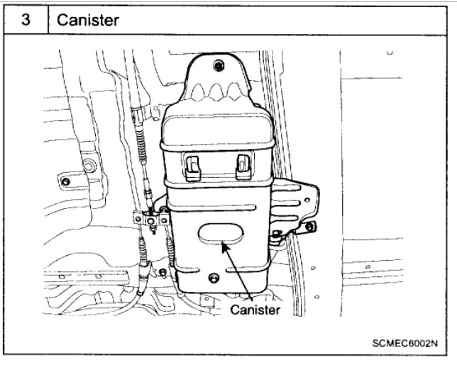

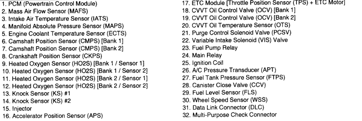

2007 santa fe 2.7 v6-where is the purge valve solenoid located , thanks
Apr 26, 2010 at 8:32 PM
  • 54,853 POSTS

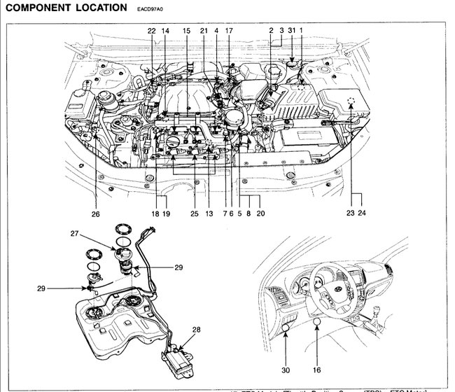

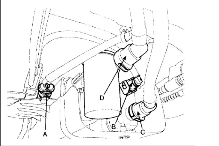

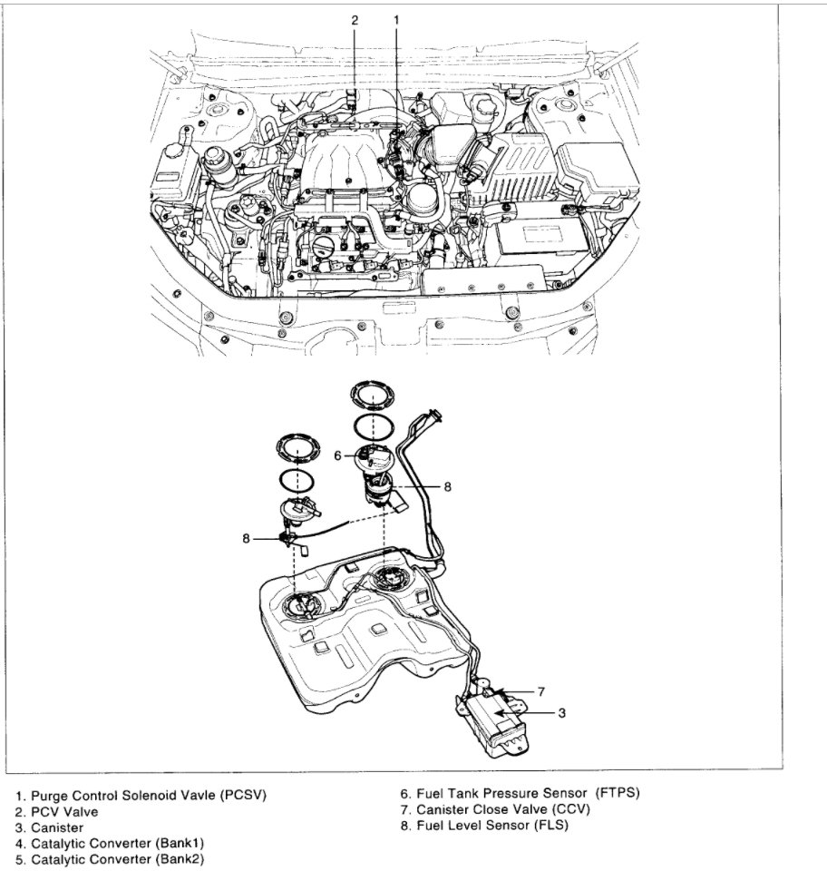

The EVAP system purge solenoid is located near the mass air flow sensor. Here are some diagrams to help you find it (below)
Please let us know if you need anything else to get the problem fixed. These are for both engine BTW
