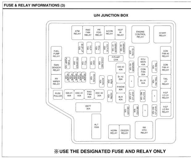

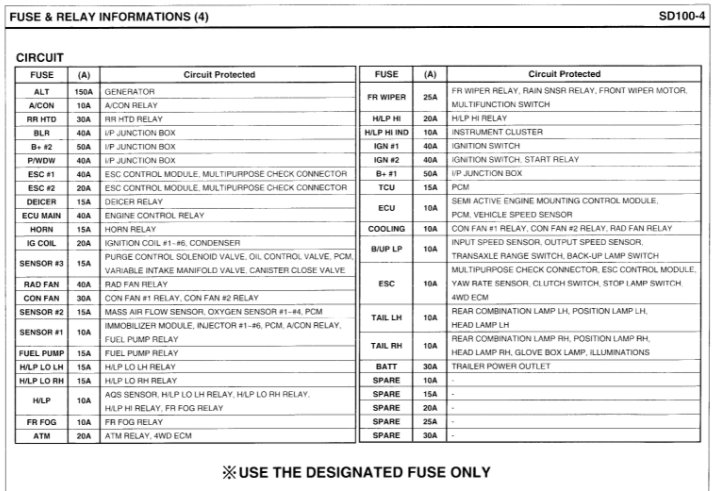

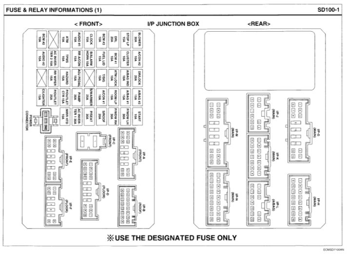

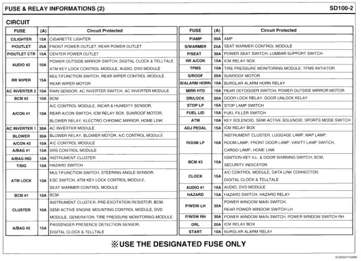

Would a radio fuse make it stop working? I need to check the fuses can help help?

Here is the information you requested. Here are a few tutorials for you to view on how to check and replace fuses:
I've attached pictures below showing the fuse and relay locations on your Hyundai Santa Fe. Hope this helps and thanks for using 2CarPros.
