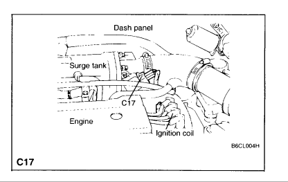

I want to replace the throttle position sensor in a 2004 Sante Fe. Where is this located and for a novice, how long should this approximately take?
Friday, January 1st, 2010 AT 9:34 PM
13 Replies
  • 75,992 POSTS
Its gonna take about lil bit over 1/2hr see location below
https://www.2carpros.com/forum/automotive_pictures/12900_tps_1.gif
+1
Friday, January 1st, 2010 AT 9:46 PM
MOVINONUP12000
Rasmataz, thank you. The information you provided was very helpful. It took only 20 minutes.

I am trying to replace the TPS on my 2004 and can not find it on the vehicle. Do you have a picture or diagram on where I might find it on the 3.5L engine?
Thanks Matt
Saturday, January 21st, 2017 AT 1:40 AM (Merged)
  • 75,992 POSTS
Don't have the info on this but normally for the Tiburon/other models its located within this area-check there
MDPRATHER
Thank you, will check again at first daylight :)

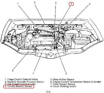

GRIFF09
  • 2001 HYUNDAI SANTA FE
  • 4 CYL
  • 2WD
  • 120,000 MILES
Engine Performance problem
2001 Hyundai Santa Fe 4 cyl Two Wheel Drive Automatic 120000 miles
I have been experiencing rough starts and issues with high/low idle for a couple of weeks, along with the check engine light recently coming on. Diagnostic check shows problems with oxygen sensor and throttle position sensor.
I don't have a problem locating the Bank 1 oxygen sensor 1, but the throttle position sensor is a new one. Can anyone assist in sharing where this is located, and how I replace it?
BLUELIGHTNIN6
  • 16,542 POSTS
Hello
Thanks for the donation.
Your TPS (Throttle Position Sensor) is located on the right side of the throttle body of your 2.4L engine.
https://www.2carpros.com/forum/automotive_pictures/261618_Noname_112.jpg
Removal and installation of the TPS is quiet simple.
REMOVAL:
Disconnect the TPS harness connector and remove the mounting screws. Remove TPS from throttle body.
INSTALLATION:
To install, reverse removal procedure. Tighten the TPS mounting screw(s) to 13 - 22 Ft. Lbs. (1.5 - 2.5 Nm)
Hope this helps..
Thanks for using 2carpros.com!
