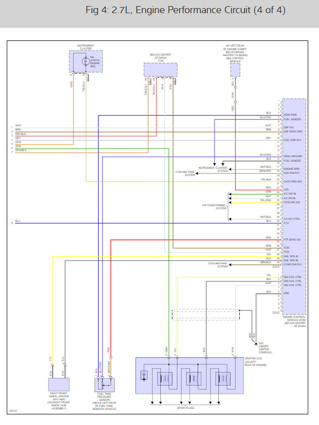

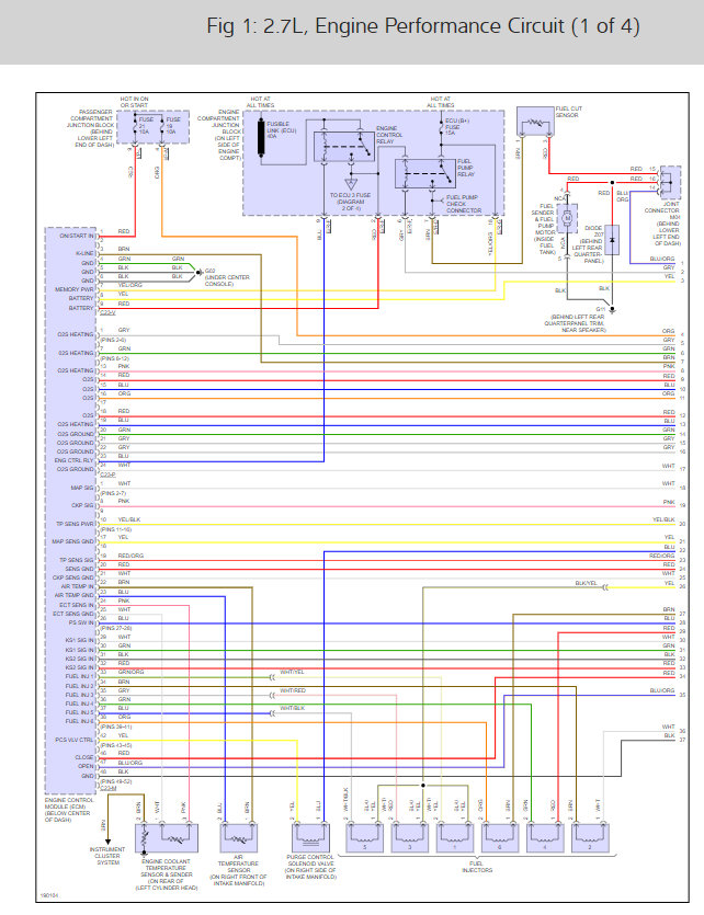

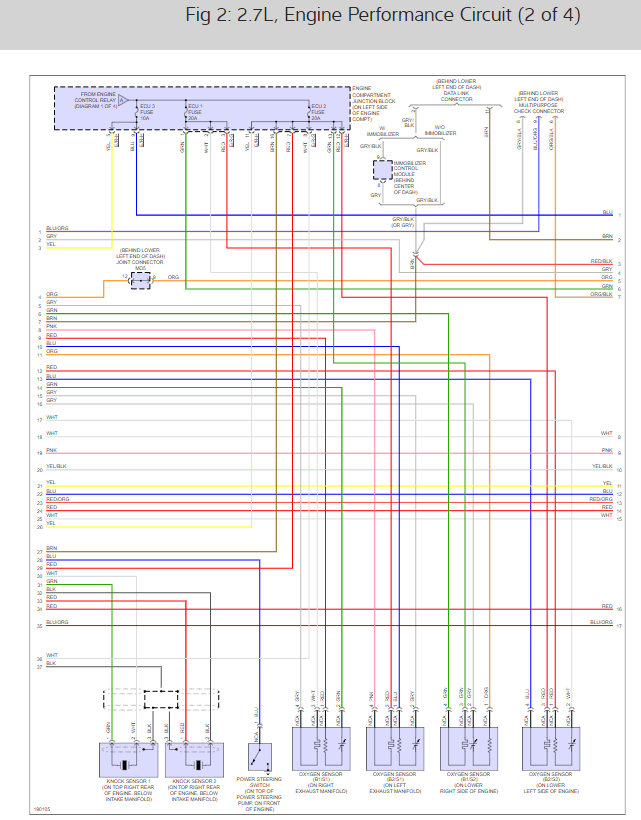

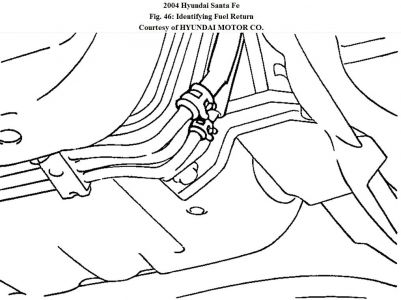

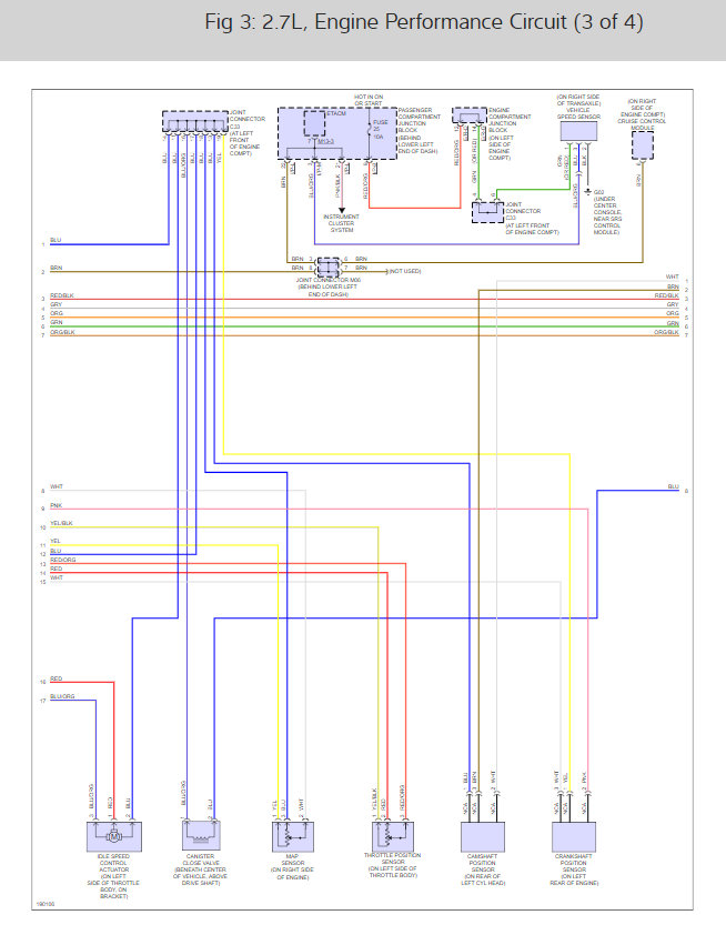

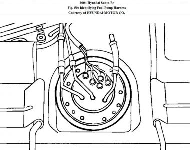

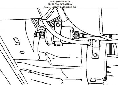

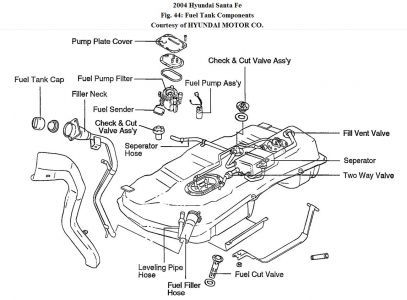

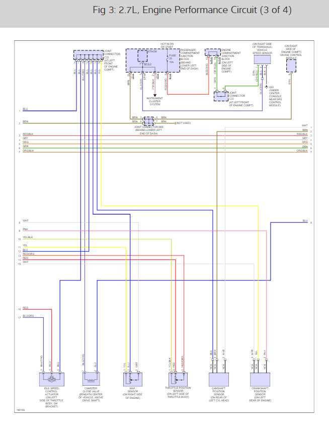

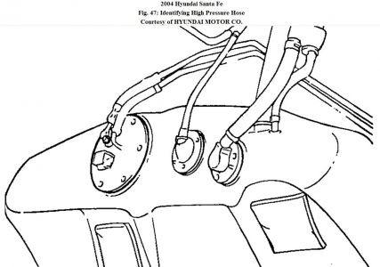

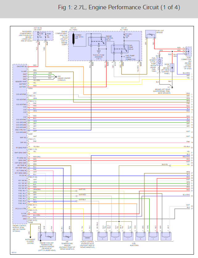

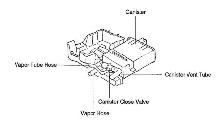

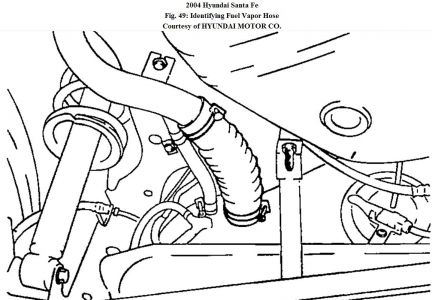

Where can I get a diagram of the fuel replacement instructions please?
Sunday, July 11th, 2010 AT 9:54 AM
MERLIN2021
MECHANIC
17,250 POSTS
These are what I found for you, in addition there are injectors on the engine and fuel lines to attach to the tank.
The fuel pump wiring diagrams or below with the engine wiring as well
