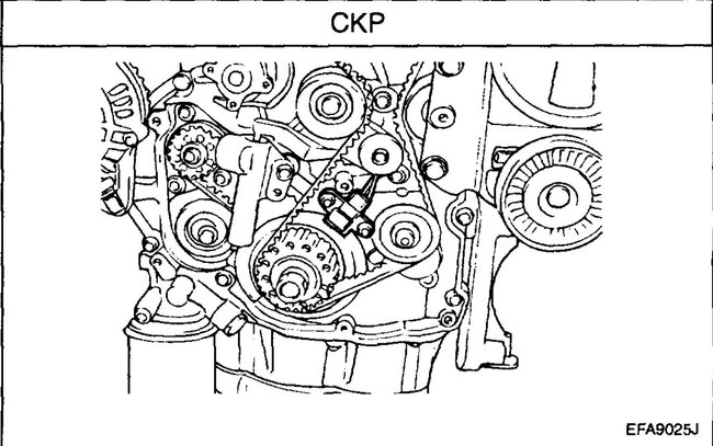

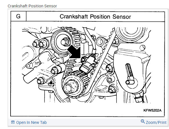

Patrick:
It is located behind the timing cover, you will have to remove all of the belts and brackets to get the cover off to replace it.
Check out the guide below, its not vehicle specific but it will give you an idea of whats involved
See the diagram below for the location of the sensor on your vehicle

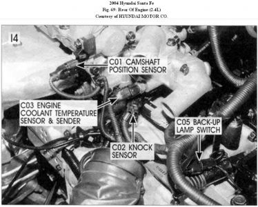

where is this sensor located on the motor and do you have a pic for the location.
Jan 23, 2019 at 4:55 PM (Merged)
KHLOW2008
  • 41,814 POSTS
Hi RobertJ0929, Sensor is located at rear of engine.

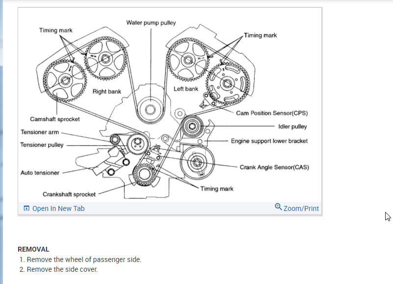

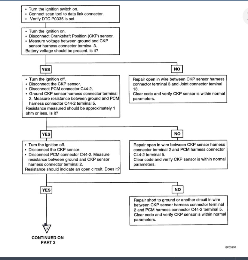

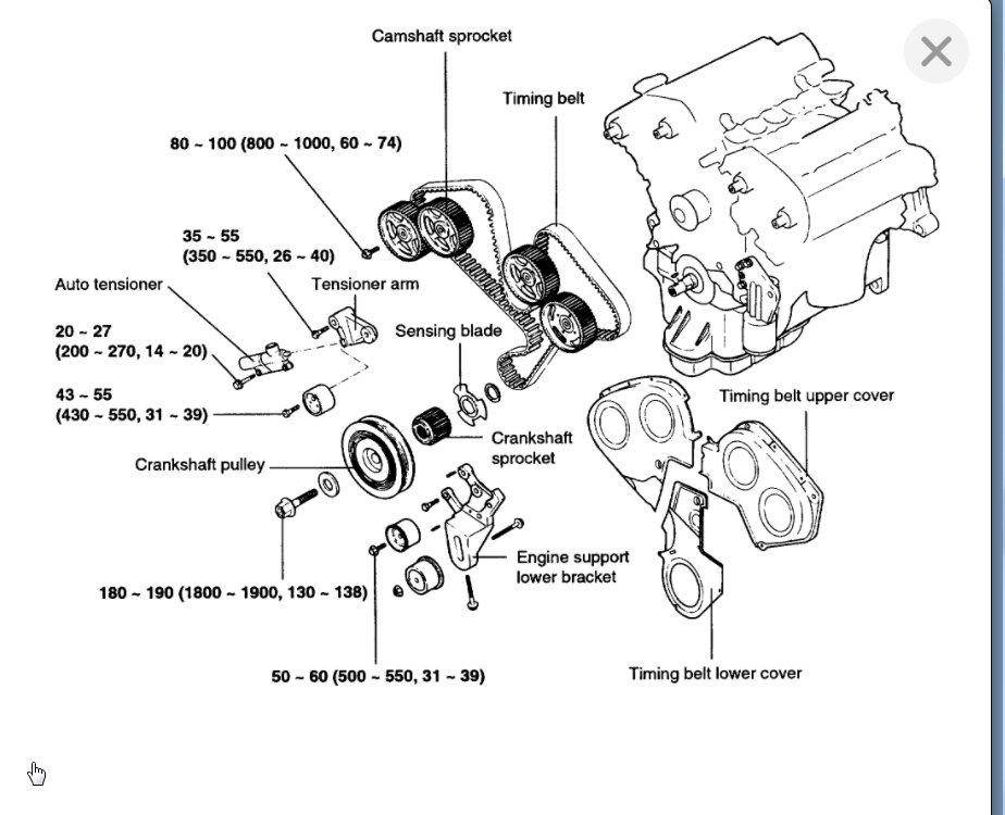

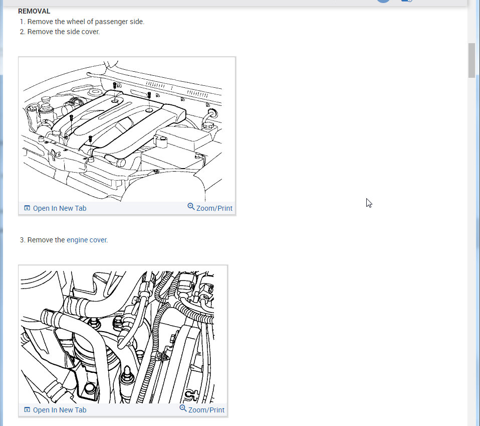

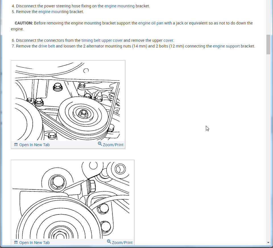

DONALD MCKEE

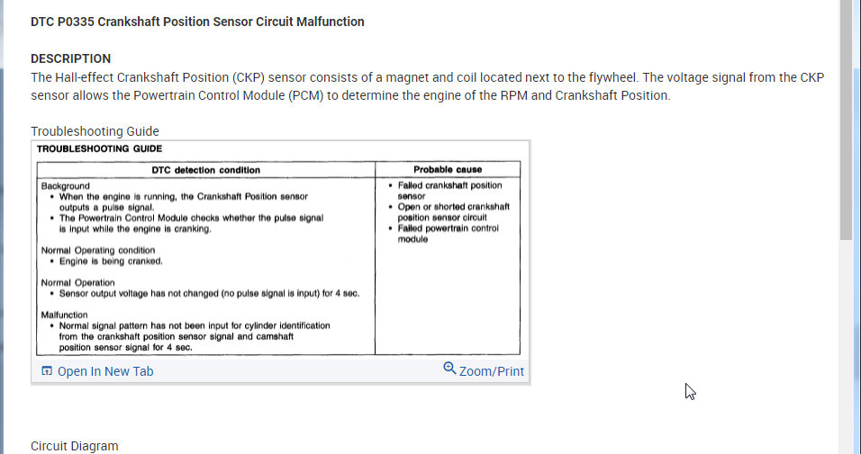

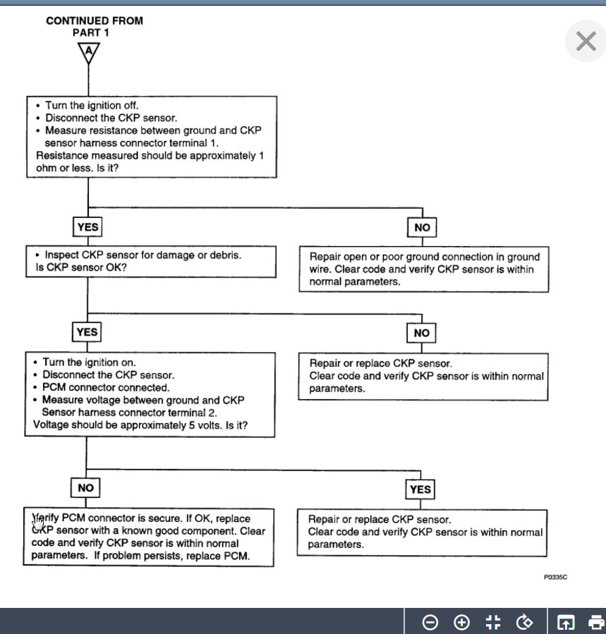

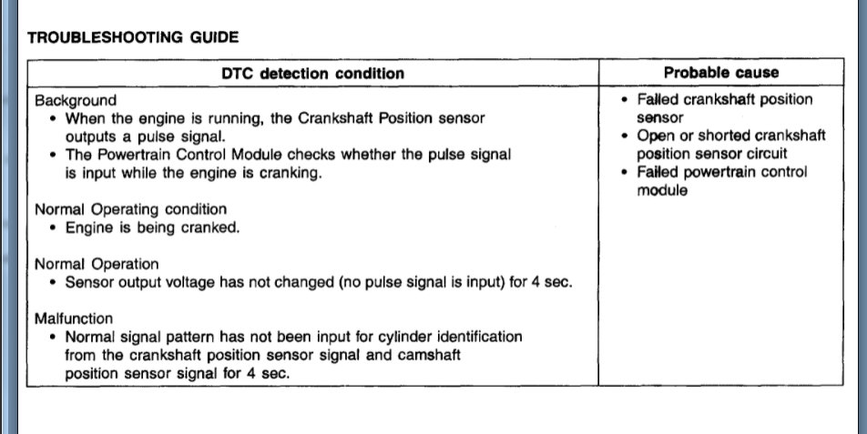

2003 Hyundai Santa Fe GLS 3.5l v6 2wd dual transmission showing code p0335. how do I get to it to replace it?
Apr 28, 2021 at 9:27 AM
You need to remove the timing belt cover to access it. I attached the info below but before you do, I would run through the testing just to be sure this is the issue. There are other causes of this code and if you didn't need to remove the cover to get to it then it may be worth just taking a shot at it but I would not want to be wrong after doing this.
