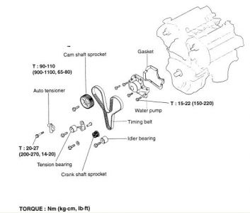

Where is the water pump located on the engine and how do you replace it?

is this for the 2.7L or 3.5L engine?

The Santa Fe in question is a 2.7 L V6.

Drain the cooling system. Remove or disconnect the following: Negative battery cable Drive belt and water pump pulley Timing belt covers Timing belt tensioner Idler pulley Water pump bolts Water pump and gasket Clean the gasket mating surfaces.
https://images.2carpros.com/forum/automotive_pictures/261618_Noname_1728.jpg
Install or connect the following: Water pump and gasket Bolts and alternator bracket. Tighten the bolts to 11-16 ft. lbs. (15-22 Nm). Idler pulley Timing belt tensioner Timing belt covers Water pump pulley and drive belt Negative battery cable Fill the cooling system. Start the engine and check for leaks.
