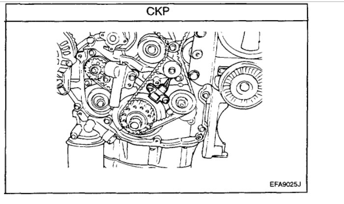

The crankshaft sensor is located at the front of the engine down at the timing belt pulley. You will need to remove the timing belt cover. here is a diagram to help you see what I am talking about. The six.
Here is a guide that can give you more information on the job:
Here is what it will be like (below) for four and six cylinder engines.

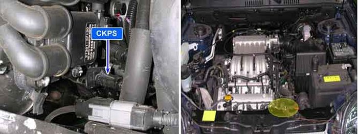

I looked for about an hour last night in this area and could not find it. Is it under something else or hidden? I have the new sensor and know what it looks like, but cannot see it on the car. I went to the Hyundai dealership and asked a mechanic. The crankshaft sensor is above the starter on the side of the block. A bit hard to get to, but I changed it and car is running again.

Here are some pictures that should help you:

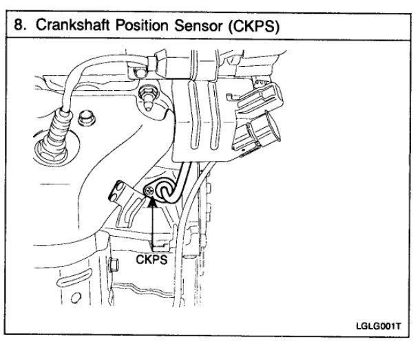

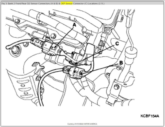

The crankshaft sensor is in the side of the block, behind the exhaust manifold. https://www.2carpros.com/images/external/139983558.gif Part# 391803E100 $74.27
Dec 29, 2016 at 10:32 AM (Merged)
  • 55,423 POSTS
Hey MUSA,
The crankshaft position sensor is in the side of the block, behind the exhaust manifold.
Here is a diagram to help you locate it:
Please let us know what you find so it will help others.
Best, Ken

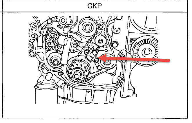

Four cylinder front wheel drive manual.
Where is the crankshaft position sensor and how long does it take to replace on a 2.4L?
Dec 29, 2016 at 10:33 AM (Merged)
  • 75,992 POSTS
https://images.2carpros.com/forum/automotive_pictures/12900_ckp_1.jpg
https://images.2carpros.com/forum/automotive_pictures/12900_ckpp_1.jpg

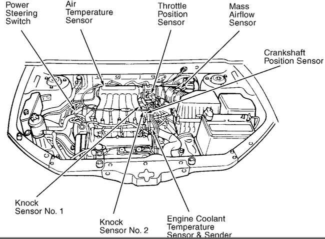

My SUV suddenly would not shift into second gear going down the highway. I babied it home and noticed also that placing it in reverse the engine immediately quit. Idle the car and it is fine. Placing it in drive it jumps. So I took out my computer check tool and it said the crankshaft sensor was bad.
So I guess I need to know where this is located on the engine? Thanks, Mark
Oct 12, 2017 at 8:11 AM (Merged)
HMAC300
  • 48,601 POSTS
I doubt it is your crank sensor, but here is location in picture. if it still does it have a transmission professional check it. It may be a governor or in need of transmission rebuild.
MCAVINEE
  • 69 POSTS
Reason I said the sensor is my tester gave me the p003 and said crankshaft position sensor. Somebody told me that I would have to remove the timing belt cover and crankshaft pulley. You are showing the sensor at the top of the engine?
HMAC300
  • 48,601 POSTS
that is what our book says its location is.
