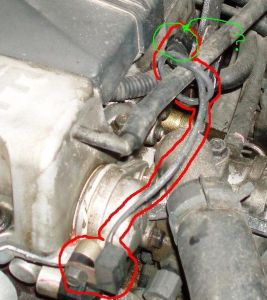

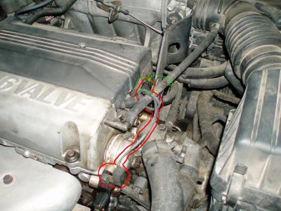

Dear all,
I had my 1999 Hyundai Sonata 4 cylinder car repaired for oil leaking and replacing the seal. However, after I got home I found this cable hanging around, I went back to ask the mechanic who fixed my car, but he could not answer me what exactly where it connected to. He told me might it be there since I bought it. I had do some researh from the Hyundai car manual, it look like a camshaft connector, but I am not sure where was it connected before.
I attcahed a picture of the cable I had described, if anyone out there known what it is and where should it be connect it to, please let me known, I will really appreciate for your helps.
Thank you very much.[img:0600d7cd73]http://www.2carpros.com/forum/automotive_pictures/74544_99_Hyundai_sonata_1.jpg[/img:0600d7cd73][img:0600d7cd73]http://www.2carpros.com/forum/automotive_pictures/74544_99_Hyundai_sonata_2_1.jpg[/img:0600d7cd73]
May 17, 2007 at 10:57 AM
XYANDAI
I found the problem, it was an IAT sensor cable, previously scan with the OBDII scanner had found nothing. This morning took out the cover and found an empty connector, I connected them pull out just to make sure it fix. Later today I scanned the vehicle again just want to see what is the difference before it was connected, guess what I found an error code IAT malfunction code P0110.
