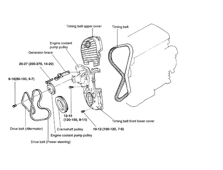

Hi ...I am looking for information on how to change a water pump on a 1999 Hyundai Sonata. Or if anyone could tell me where I could find this info online with possible diagrams would be great. Thanks, Kim

You must start by draining the coolant, the water pump is behind the timing belt cover.
Here is a diagram that will show you what to do
