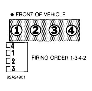

Hello i have unplugged all my spark plug leads and cant remember when each one replugs into could you help?

Hope this helps.It is the same for a 1.6 or a 1.8 engine
