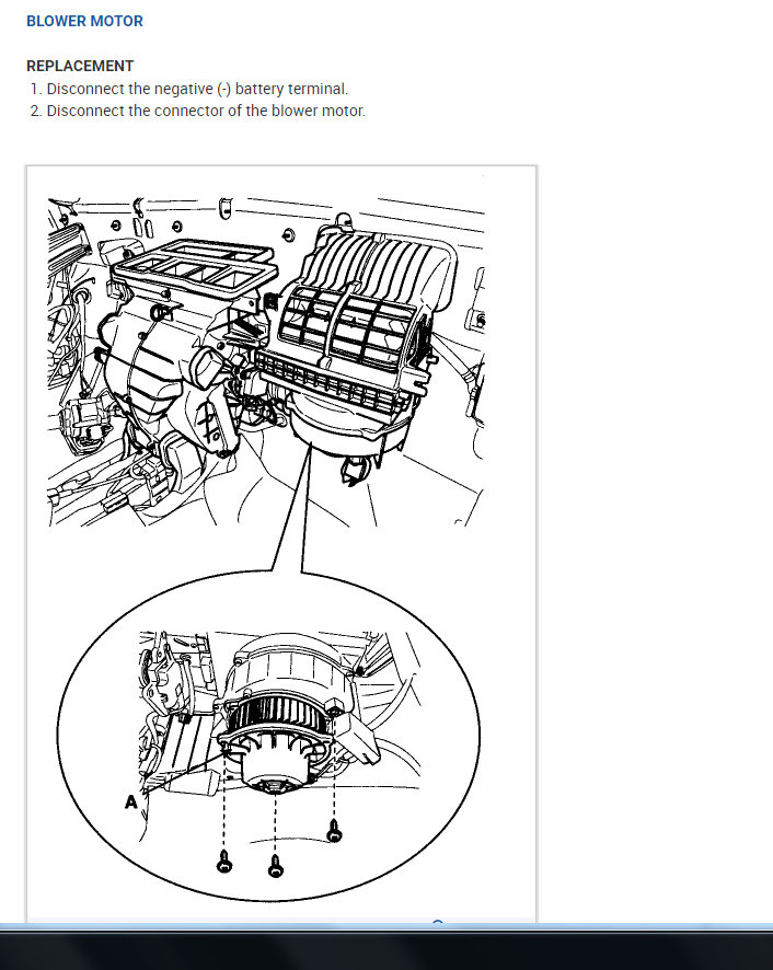

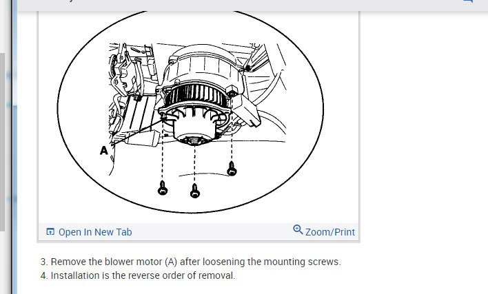

Lastly you will see below the process from the manual on how to replace the blower motor if this proves to be the issue.

Inside blower motor assembly. Check out the diagrams (Below). Please let us know if you need anything else to get the problem fixed.

it's behind the glove box it only pays a half hour to replace it so it can't be that hard to change.Make sure you have power and ground to it when it isn't working before you change the motor.

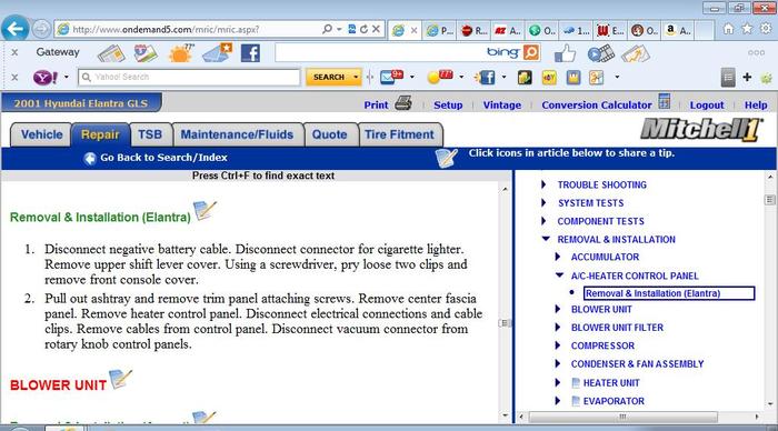

Here is how to remove the ac controls.
