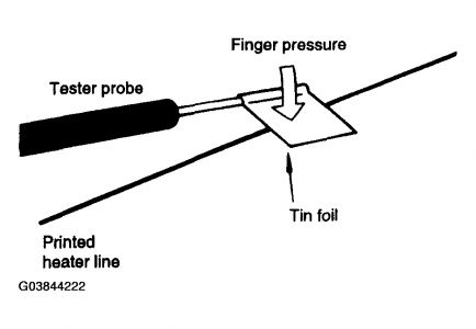

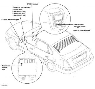

i had body work done and they remove the rear window. When I got the car back the rear defroster didn. Work, the switch work but the rear defroster doesn't. I can't seem to find the connection by the rear window for the defroster. Can you help

Fig. 2: Using Tester Probe With Tin Foil
Courtesy of HYUNDAI MOTOR CO.
Turn on the defogger switch and use a voltmeter to measure the voltage of each heater line at the glass center point. If a voltage of approximately 6V is indicated by the voltmeter, the heater line of the rear window is considered satisfactory.
Fig. 3: Measuring Voltage Of Each Heater Line At Glass Center Point (6 Volts)
If a heater line is burned out between the center point and (+) terminal, the voltmeter will indicate 12V.
