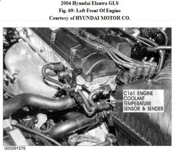

2004 Hyundai Elantra 4 cyl Two Wheel Drive Automatic
Replace thermostat, where is it located?

Hi TJDonegan, Thank you for the donation. The thermostat is located behind the thermostat housing on which the ECT is installed. It is attached to the lower radiator hose. Remove the lower radiator hose and the housing attached to it you would get the thermostat.
https://images.2carpros.com/forum/automotive_pictures/192750_ECT04Elentra_1.jpg
