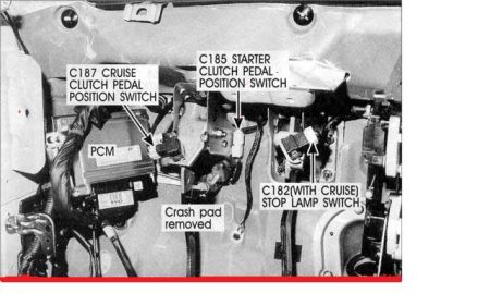

When I depress the cluth to allow the ignition to start the car, I can't seem to press it far enough to make it work. I have been able for the last couple days to just push it into the floor harder but I believe I am out of pushes. Can you point me in the right direction to avoid the dealer or am I bound to pay their prices?

you can start by replacing the switch not a bad job if you a bit handy its on the clutch paddle
https://images.2carpros.com/forum/automotive_pictures/99387_clutch_hyun_1.jpg
