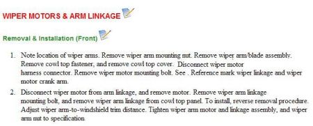

How do I replace the wiper motor?

https://images.2carpros.com/forum/automotive_pictures/261618_Noname_1730.jpg
