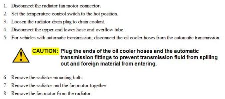

I need to know how to replace radiator in a 2002 Hyundia Elantra
