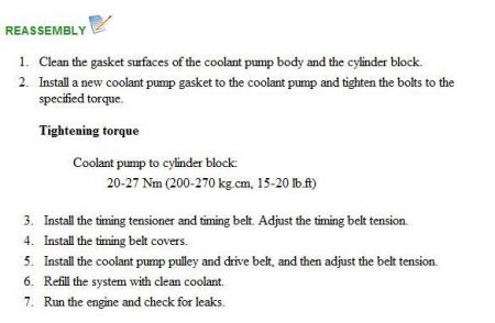

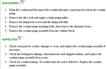

My car is over heating and I think I need to replace the water pump. How do I do it?
