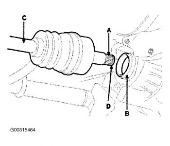

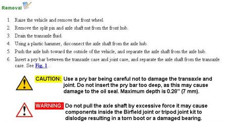

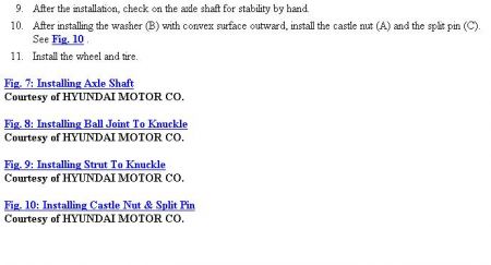

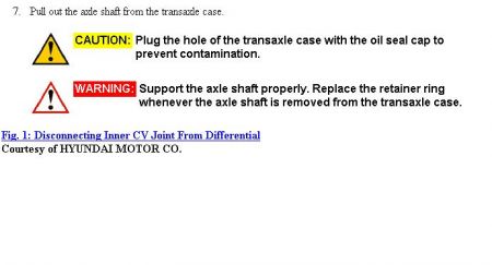

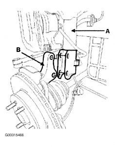

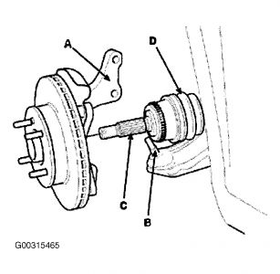

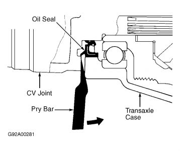

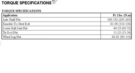

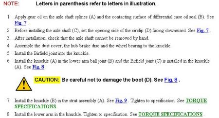

Trying to save some money on removing and installing new front axles for my 2002 Elantra GT. It would cost me more than $300 dollars to have them replaced and installed, when I should be able to do it myself for half the price. Looking for step by step removal and installation instructions.. Thanks in advance for your time and assistance.
