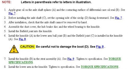

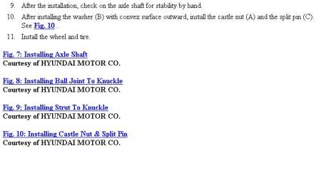

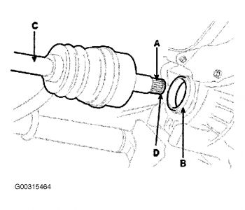

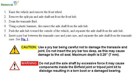

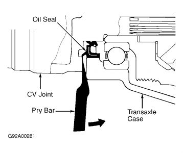

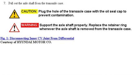

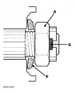

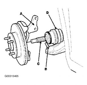

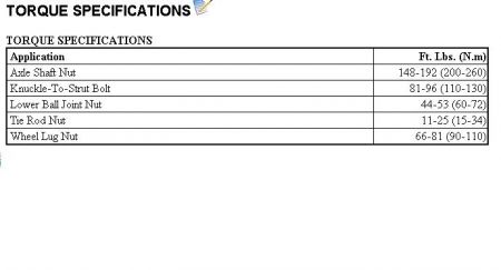

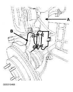

Trying to save some money on removing and installing new front axles for my 2002 Elantra GT. It would cost me more than $300 dollars to have them replaced and installed, when I should be able to do it myself for half the price. Looking for step by step removal and installation instructions.. Thanks in advance for your time and assistance.

https://images.2carpros.com/forum/automotive_pictures/55316_02elantraaxle1_1.jpg
https://images.2carpros.com/forum/automotive_pictures/55316_02elantraaxle2_1.jpg
https://images.2carpros.com/forum/automotive_pictures/55316_02elantraaxlefig1_1.jpg
https://images.2carpros.com/forum/automotive_pictures/55316_02elantraaxle3_1.jpg
https://images.2carpros.com/forum/automotive_pictures/55316_02elantraaxle4_1.jpg
https://images.2carpros.com/forum/automotive_pictures/55316_02elantraaxlefig7_1.jpg
https://images.2carpros.com/forum/automotive_pictures/55316_02elantraaxlefig8_1.jpg
https://images.2carpros.com/forum/automotive_pictures/55316_02elantraaxlefig9_1.jpg
https://images.2carpros.com/forum/automotive_pictures/55316_02elantraaxlefig10_1.jpg
https://images.2carpros.com/forum/automotive_pictures/55316_02elantraaxle5_1.jpg

thank you very much for the detailed instructions. I will give a try. Thanks again. AVP
