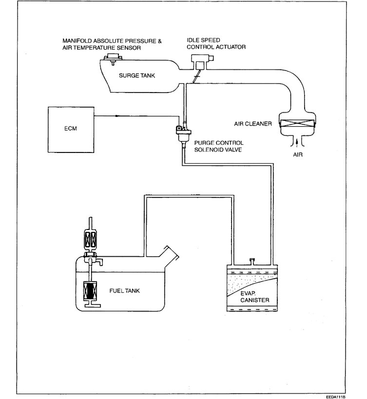

2002 Hyundai Elantra 4 cyl Automatic 122K miles

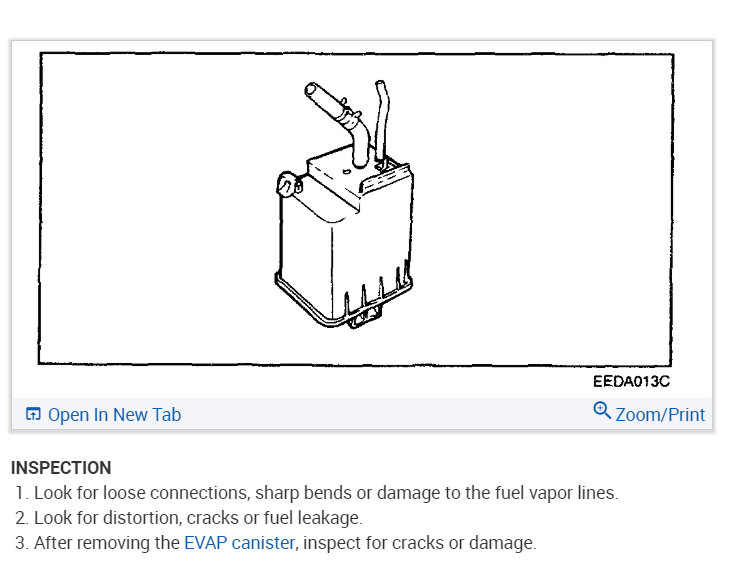

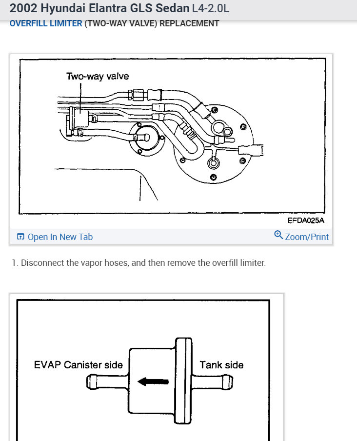

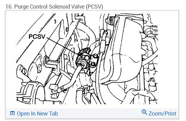

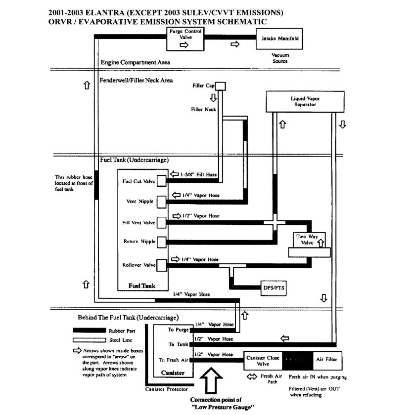

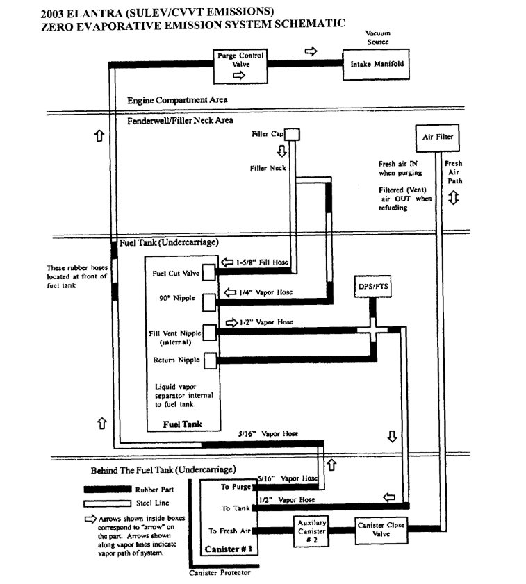

I have had the check engine light come on with the following code: Purge Flow Fault Code. I have never had any problems with the auto and majority of miles are highway. Everyone keeps telling me not to worry and that this will not hurt the engine; however, I feel anytime the check engine light is on - it should be corrected. Have went to dealer and they have told me that the Emissions Control Systems is made up of the following parts: Fuel Pres, Canister close, purge valve and canister.............. where can I find a diagram of the Emission system so that I know where each of these parts are located on the car and where would you begin to repair this problem? Thanking you in advance for your time and consideration.
Oct 21, 2009 at 8:18 PM
OBXAUTOMEDIC
  • 3,711 POSTS
Here is a diagram of the EVAP System....
