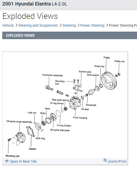

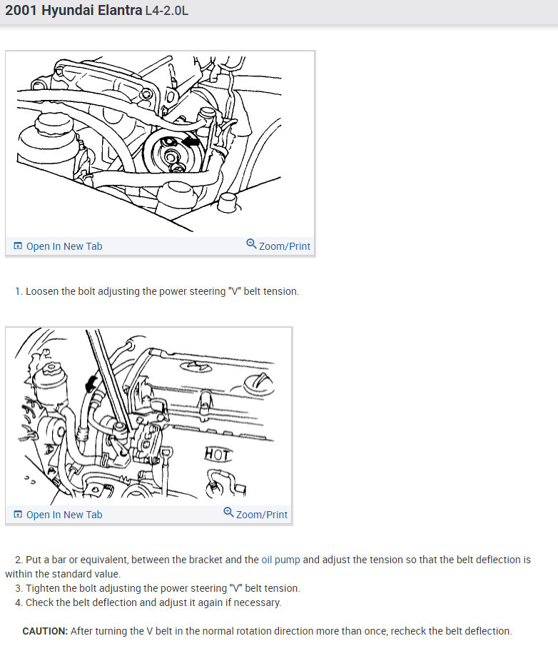

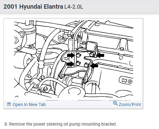

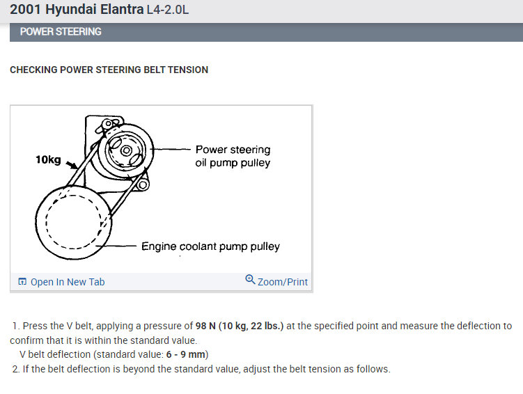

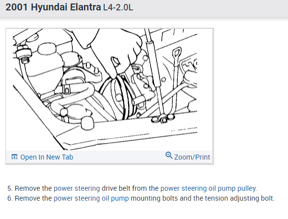

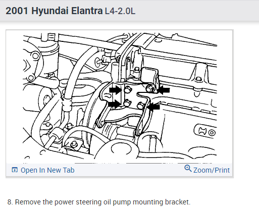

The symptom you are describing, sounds like an issue with the belt that is loose or the belt is likely glazed and just slips on the pulley without turning it.
Keep in mind if the tensioner is bad then it will be unable to keep correct amount of tension on the belt.
Check the belt and make sure it is in good condition.
https://www.2carpros.com/articles/how-to-replace-a-power-steering-pump

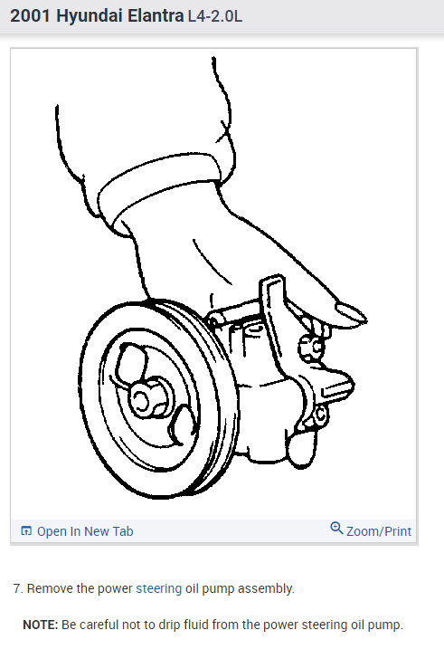

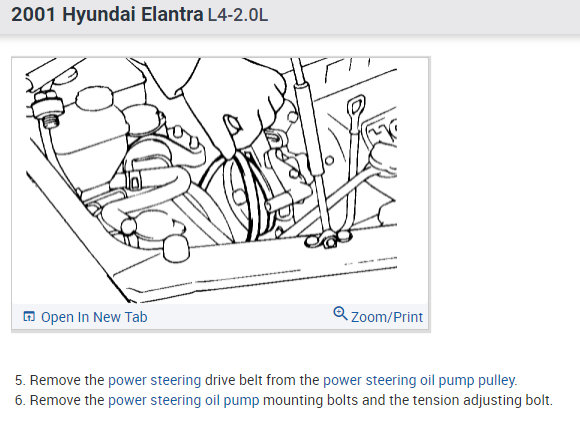

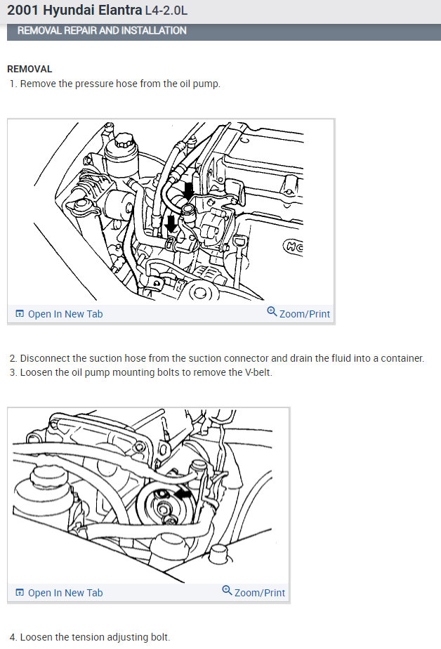

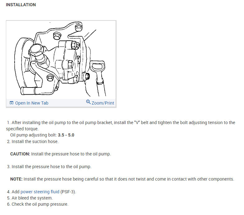

I have attached the belt adjustment and power steering pump replacement procedure for your reference.
