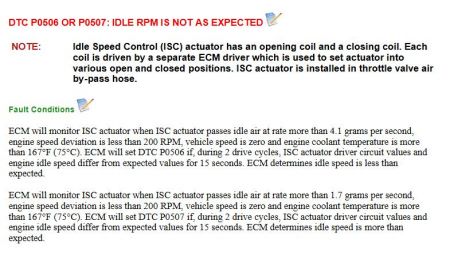

Engine was idling between ~ 1500 rpm and 3000 rpm, OBDII code was P0507. I changed the idle speed controller, removed and cleaned throttle body. Now the idle is ~ 4000 rpm continuous and it feels like I am getting gas without depressing the pedal. What do I do next?

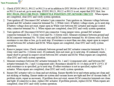

Hi Lunnyland, Is the code still showing? I have the diagnostic procedures here for P0507 and some of the things that you should check.
https://images.2carpros.com/forum/automotive_pictures/192750_P0506_0507_01Elantra01_1.jpg
https://images.2carpros.com/forum/automotive_pictures/192750_P0506_0507_01Elantra02_1.jpg
