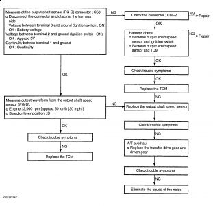

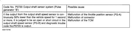

Replaced vehicle speed sensor ( SU 6201 Autozone #) located on tranny. Code is still comng on the next day. So I took off the right front wheel ,to look at the sensor, behind and to the rear of the brake disc splash cover. Took it out and clean it. Looks OK ??? ( I think its called the speed out put sensor) Anyway do I need to reset computor??? And please tell me how to anyway, because I can,t find a clear answer about it anywhere !!!! Right now the car sits ( with the negative battery cable disconnected and the key in the run possition ) It,s probably been a couple of hours since I took the batt. cable off.

Check the connection and wiring

Use a scan tool or disconnecting the battery would be the same no special procedure to resetting the codes
on this or any other car
if light return than the repair was not done correctly and the problem still the same
need to check the wiring harness if changing the sensor did not work for you

Well, I thought I replaced all the sensors , but I was wrong. After going to HMASERVICE.COM I found that the input sensor is by the air filter box. Not by the front right wheel .I have overlooked this (input) sensor. So I went to the wreck yard to see if I could find another, just to see if it would make a difference. I found most of the cars already missing this sensor. Finally I found one. The car was totaled from a head on crash, so I assumed it was running when it got hit. I went home and put the new sensor in, still got an engine light. I drove to Auto zone (3 miles), with no problem. I was going to have them do a code scan. I thought maybe that would clear the codes. When I got there I shut off the engine. Then I decided to to see if the code was still there, by starting it back up. The engine light didn't come back on. I decided I needed to put more miles on it to see if this was really the correct fix. So far 75 miles and no symptoms.
